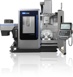

DN Solutions proudly introduces the DVF 5000 2nd Generation, a compact 5 axis vertical machining center that sets new standards for precision and efficiency.
Make the step from traditional 3 axis machining to full 5 axis capability and save up to 30 percent machining time. With extended travel, improved cooling and enhanced stability, the DVF 5000 delivers consistent accuracy and productivity across a wide range of applications.
Connected with automation options, it offers even greater efficiency and reliability in a compact footprint, ready for the challenges of modern manufacturing.

  • Compact footprint with extended work envelope
  • Handles parts up to Ø 600 × 500 mm and 400 kg
  • Extended Z-axis travel of 480 mm (+20%)
  • Positioning accuracy 6 micron
Compact and capable
High-performance spindle
  • Built-in spindle with 15 000 rpm and 230 Nm torque
  • Optional 20 000 rpm high-speed configuration
  • Stable performance across materials and processes

Table size
Ø 630 × 450 mm
Parameter
DVF 5000 2nd Gen
TECHNICAL SPECIFICATIONS
Compact structure, expanded capability
The DVF 5000 2nd Generation combines precision, power and flexibility in a small footprint - built to handle demanding materials and complex parts.
Max. workpiece
Ø 600 × 500 mm / 400 kg
Travel (X / Y / Z)
650 / 520 / 480 mm
Rapid traverse
42 m/min (X / Y / Z), 25 rpm (B / C)
Spindle speed / torque
15 000 rpm / 230 Nm (20 000 rpm option)
Tool capacity
40 / 60 / 120 tools
Control options
Siemens ONE (Std.) / Heidenhain TNC7 / Fanuc
