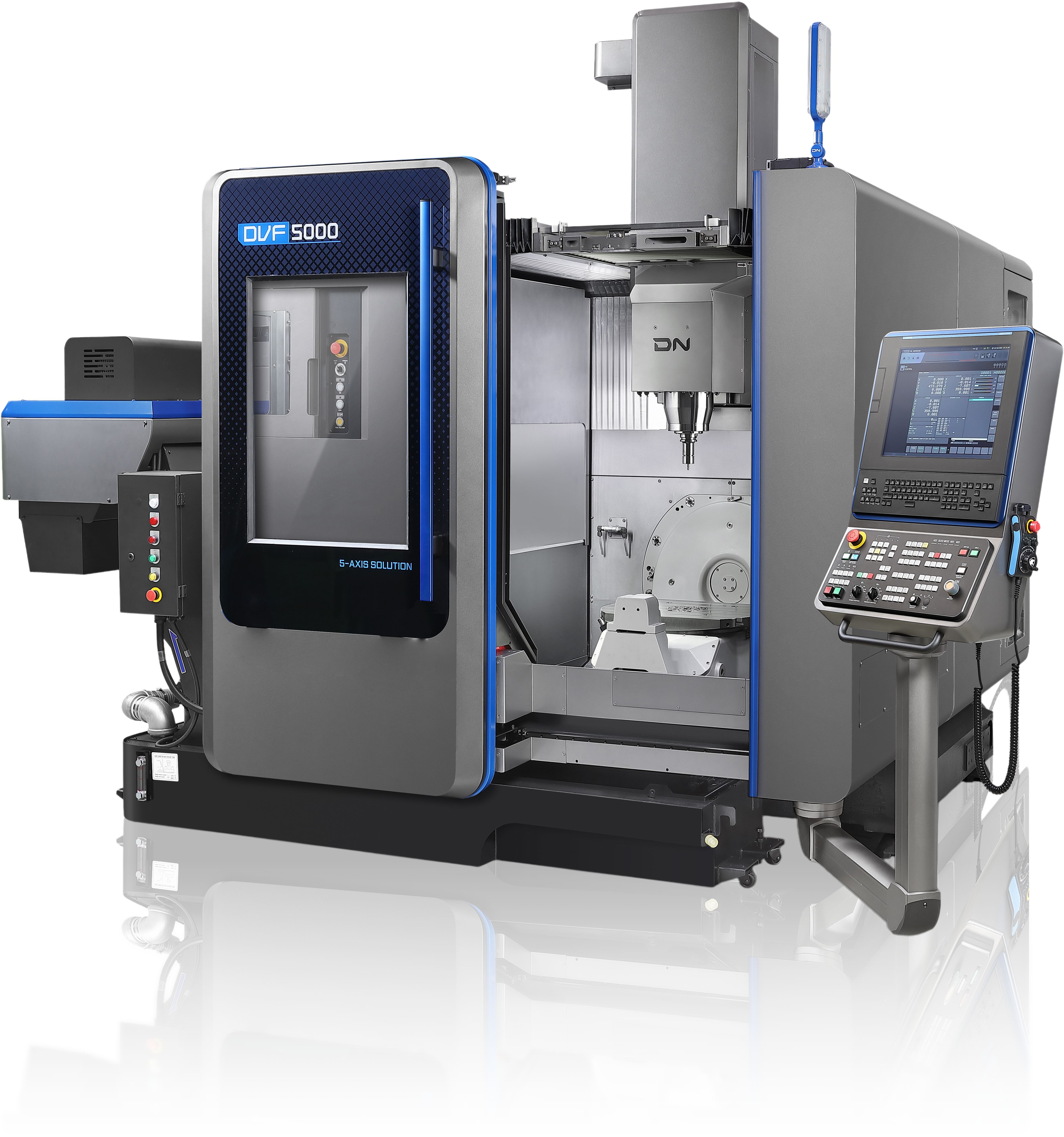

DN Solutions proudly introduces the DVF 5000 2nd Generation, a compact 5 axis vertical machining center that sets new standards for precision and efficiency.
Make the step from traditional 3 axis machining to full 5 axis capability and save up to 30 percent machining time. With extended travel, improved cooling and enhanced stability, the DVF 5000 delivers consistent accuracy and productivity across a wide range of applications.
Connected with automation options, it offers even greater efficiency and reliability in a compact footprint, ready for the challenges of modern manufacturing.
Experience next level 5 axis performance, faster, more accurate and more flexible

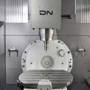

Thermal stability redefined
  • Cooling for all axes, spindle and drive units
  • 8 integrated thermal sensors for real-time compensation
  • Maintains accuracy during long production cycles

The DVF 5000 features an innovative cooling and thermal compensation system that maintains stability even under continuous heavy-load machining.Active temperature control across all guideways and motor plates ensures consistent performance and exceptional surface quality.
  • ADVANCED COOLING CONCEPT

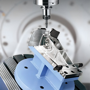

High-rigidity roller guideways, stronger ball screws and precision B/C gear-driven tables deliver outstanding accuracy and repeatability.
The extended Z-stroke allows for larger workpieces without compromising compactness or dynamics.
Optimized acceleration and rapid traverse speeds of 42 m/min (X/Y/Z) ensure fast positioning and reduced non-cutting time.
Tool magazine capacities up to 120 tools and best-in-class change times (T–T 1.3 s / C–C 3.8 s) keep the spindle running and productivity high.

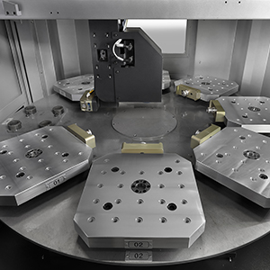

AUTOMATION THAT GROWS WITH YOUR NEEDS
From single pallet to multi-layer automation – ready for continuous production
The DVF 5000 2nd Generation is designed with automation in mind. Start simple with a Single Layer AWC for flexible small-batch production, or expand to a Multi Layer AWC configuration for high-volume, continuous machining.
Both systems provide seamless integration with DN Solutions’ control environments, ensuring smooth tool and pallet management across shifts.
Combined with an optional round tool magazine and intelligent pallet handling, the DVF 5000 enables true 24/7 performance with minimal operator intervention.
Compact and automation ready
Compatible with round magazine, single and multi-level AWC systems for continuous, unmanned production.
